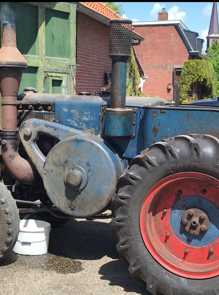

I also have a 85xx (1941) without brakes and without foot throttle. Mine was originally exported to the Netherlands.
A bit strange is that my 85xx has an unusual air-inlet for Europe, but similar to the ones on the Pampa Lanz. I have not yet seen another European Lanz with that air-inlet originally fitted.
Does anybody have an idea why it is divergent?
I still have not been able to identify if it is a 8500 or 8506. Originally the tractor come on iron wheels, but it has 6 gears. I doubt the farmer converted to 6 gears in the 50ies or 60ies. I don't know if it was common to do that back than?
